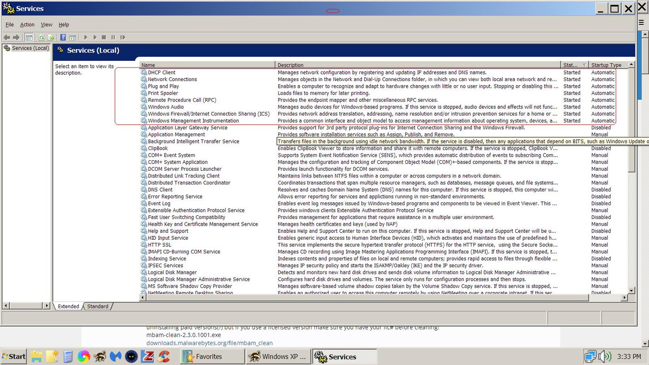

    Well ... its not for the 'faint of heart' and I don't recommend anything that people aren't comfortable with.
    But these are the ONLY services I have set to Automatic.
    xperceniol, Dec 22, 2022
    #31
  12. usingh066397
    xperceniol
    May 24, 2022
    266
    211
    These are what I have disabled and other are manual.
    #32

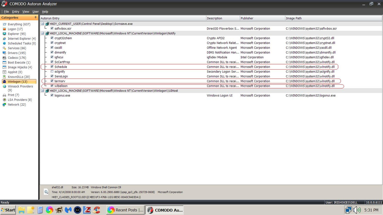

    Does anybody know if I can safely disable the following:
    ~Schedule (I don't schedule anything)
    ~termsrv (I disable this service)
    ~Wlballoon (I also have balloons disabled)
    Thank you in advance :)
    -Sal
    xperceniol, Dec 23, 2022
