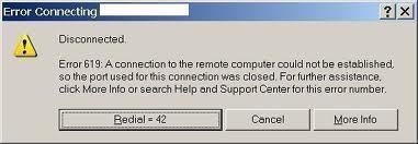

How to Fix Error 619
Step 1 – Right click the “My Computer” icon on the computer’s desktop.
Step 2 – Select “Properties” on the subsequently displayed menu.
Step 3 – Choose “Hardware” then “Device Manager.”
Step 4 – Right click the modem on this screen and select “Disable.”
Step 5 – Exit the screen and restart the computer.
I got the above info from here:
http://www.tech-faq.com/error-619.html
also check to see if you can get into the internet during safe mode with networking?
also how many users are there on you pc?? there should be the built in administrator and then your user account, guest should be disabled and also asp.net that gets installed with .net 2 framework, are there any others??

8. Then from there you can go directly to the hardware manufacturers website and get the driver.
when you go to device manager and right click on a device, you will get a drop menu that has these listings:
you might go to one of the driver download sites that could scan you computer and show you what drivers you need,
https://www.slimwareutilities.com/slimdrivers.php
or read here and choose one:
http://www.pcmag.com/article2/0,2817,2419843,00.asp
I have the following files for pinball, see if they are on your pc:
H
Hi Liz. I'm back. Sorry to bother you again. Have gone into device manager and found the ven and device numbers for the three drivers I'm missing. When I click on devices, there are a quite a few, don't know which one to pick. Went onto slimwares and was leery about it especially after McAffee did not want me to download the 360 program. Said there was a virus. The downloads that I got from you before, would they be suitable. missing Videv controller, vga compatible- multi media controller and ethernet controller. Now that I have come this far, I don't want to screw it up. Any suggestions greatly appreciated. Thanks. Jim
https://kc.mcafee.com/corporate/index?page=content&id=KB51573
MA 5.0.3 is the last version that supports xp, according to above, I would not use this antivirus but you should go to the 360 by qiho as it is still supporting xp, download it to a flash drive, disconnect from the internet, scan with malwarebytes free edition . I would trust that before mcafee and there is also virus total:
https://www.virustotal.com/
where you can browse for a file and have it scanned by virus total.
if you download from the 360 home page there should be no infection, but I always download to desktop and then scan any download with malwarebytes and 360, I have been using 360 for about 3 years.
if you do not download slimdrivers from download.net, which is not a very good reputation it should be fine.
as for the drivers, please provide me with the 2 ven and device numbers for each and I will check them out for you. :)
Hi again.Here's the info. Videv controller, ven 8086, dev 2562, Multi media controller, ven 8086, dev 24C5, Ethernet controller, ven, 160C, dev, oooo. Thanks again. Jim
