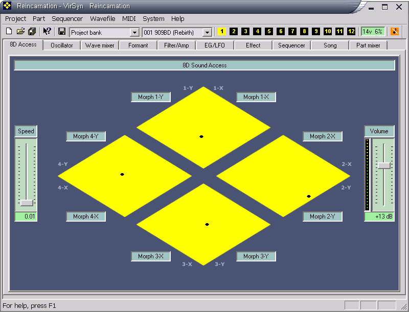

The original first product from VirSyn which was a standalone Synth Composition Program with 12 channels multi-timbral... Quite a piece of code... One can also thru a virtual MIDI port use this as a MIDI sound module & since it has audio 'capture' everything is complete... Has a variety of MIDI Sync modes...
Sounds very good to my ears the FX sectors nice, smooth & plenty power...
I had made a tune which at the time I had stability problems but most all went away when I changed compatibility mode to 'Windows 95'...
This is all synth generation no you can't load WAVs or any other samples but there's plenty of drum sounds anyway & well thought-out synth presets...

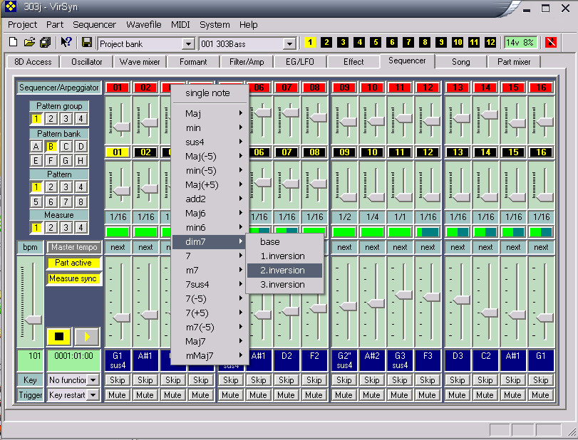

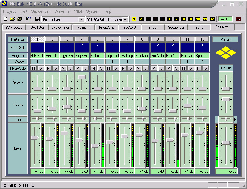

There's automation of sorts in the sequencer area but other automation would be done 'realtime' as you are capturing audio manipulating the XY pads whilst the tape runs...

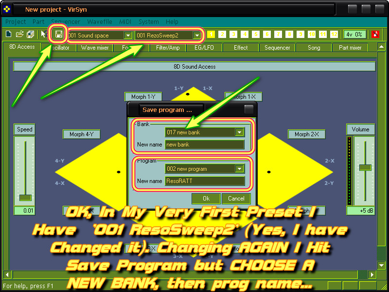

Could you please tell me how to add new samples without replacing earlier ones? For example, I create one sample, set repetitions to 3, insert, then use 8D Access to make another with repetitions set to 4, insert, yet both sound the same! Could you please tell me what I am doing wrong in the "Song" tab?
Hopefully this helps... Glad to see you are into it... When you start piling some FX on the power will be quite apparent-
