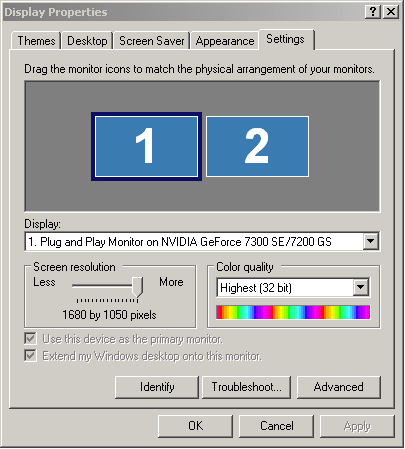

Before we go any further we need to confirm that you have the correct video driver. Right-click in the desktop and select 'Properties'. Hit the 'Settings' tab. Take a screenshot and post it here.
Yours of course will be different but we need to see this to help you further.

Very odd that is shows [Default Monitor] on
It should show Intel..Anyway, try moving the slider to a higher resolution then hit apply. Don't worry if it doesn't look right or you get a blank screen, it will revert back to the original resolution if you don't touch the mouse or keyboard.
Paste a screenshot of your device manager - we need to see what it shows under display adapter. There does seem to be some kind of driver installed or you wouldn't get 32 bit color depth.
VGAsave is a generic video driver when it can't properly detect your video or it is faulty. Download the video driver from the link Madeleine provided using MyPal 68 and install, reboot then check device manager. If it still displays VGAsave there is a problem with the onboard video. You have one of two choices: Take it back to the PC repair shop and have them troubleshoot or install an XP compatible NVidia GTX card (preferred).
