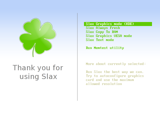

    If we use that cable can that slax app somehow be run to then test condition of the USB hardware?

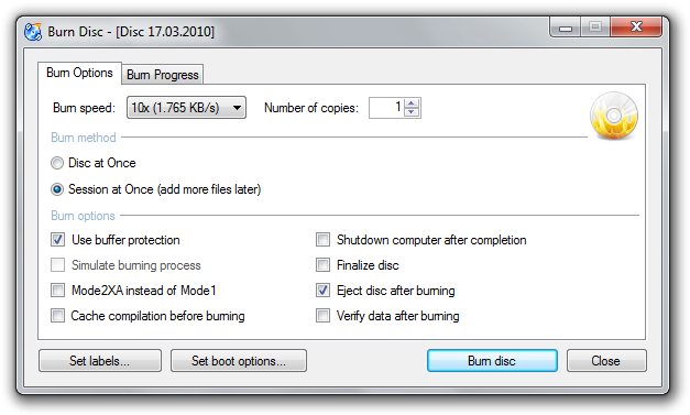

    If you can't get that CD to boot then we're at a standstill. Some optical drives don't like DVD RW which is why I recommend CDR. You didn't mention the PC was Windows 10 which has CD/DVD burning built-in. Imgburn is good but not for novices so instead I recommend CDBurnerXP (Freeware).
    https://www.cdburnerxp.se/
    Choose the slowest burn speed allowed. Choose 'Disc at Once', Make sure you select 'Finalize disc' Ignore the 'Set boot options' button, that's to create a bootable dics - the ISO is ALREADY BOOTABLE. I tested it on my old Compaq V2000, it booted fine, that's where I got the screenshots from.
    The crossover cable will not help here, it's strictly for networking your two computers. You have one PC with working USB therefore you will be able to copy contents from/to the one with bad USB ports.

    After reading through the thread, this is most likely a hardware issue. You can confirm that by booting that slax cd and seeing if your usb keyboard works. If it doesn't, then probably a hardware issue. A workaround may be to install a usb card.
