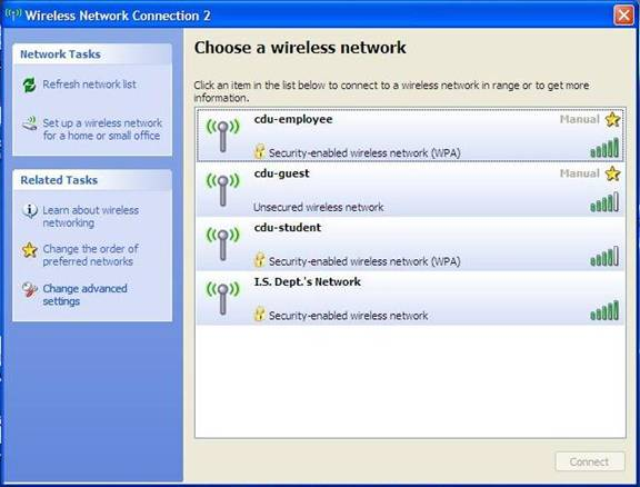

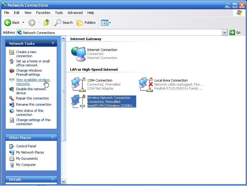

    If you're seeing "New Hardware Found 802.11 n WLAN" then it appears XP has successfully detected and installed the correct drivers. Reboot. Then go into Control Panel -> Network Connections, select the new WIFI adapter and on the left panel click "View available wireless networks".
    You should see a list of WIFI networks in range.
    Click on the one you want to connect to (you will need to know the password, I can't help you with that) and it should connect.

    I know what you are talking about. but I am not getting these choices on this view.
    Says found new hardware, now it wants to load drivers & asking for install CD.
    Choice of available Wireless network is not showing up on Network Places.
    Giving me Comcast, & LAN options to connect to Internet
