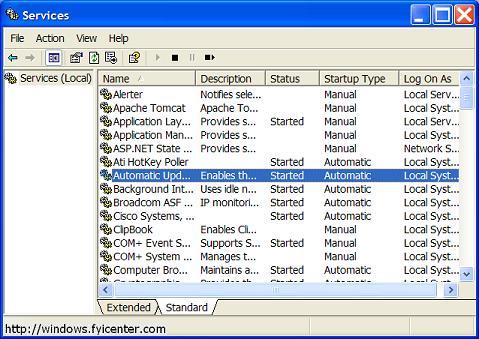

    go to control panel, administrative tools, services, click on services, then in the dialog box that opens, scroll to Automatic updates, insure that it is disabled and stopped, see
    picture:
    and then double click on the update and you can disable service see below:
    Elizabeth23, Nov 3, 2017
