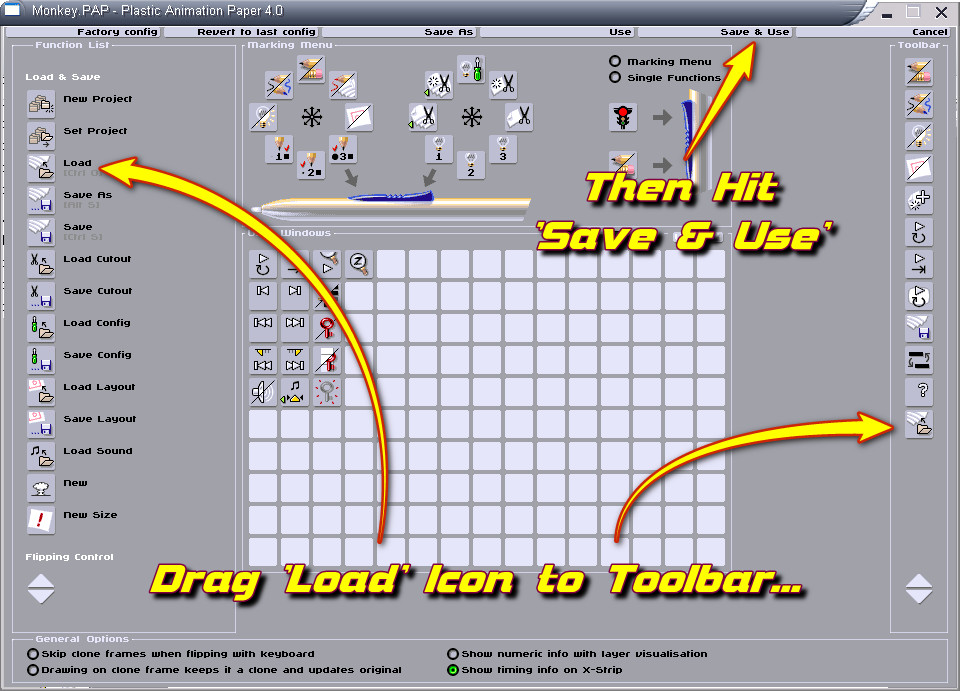

When you install it has projects that install too, You gotta install a 'Load' icon onto the main toolbar to load them in like so-
