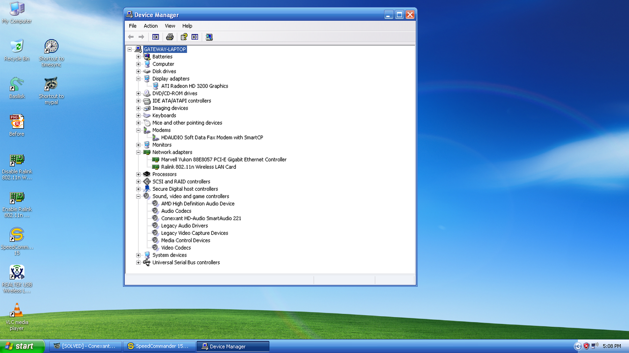

Restored the image I made, connected my USB WIFI and instead downloaded SnappyDriver Installer (Open Source, no bundled software of any kind, just installs drivers).
https://sdi-tool.org/
15 Minutes later this was the result:
Everything works, no unknown devices.
Highly recommend Snappy Driver Installer - it works as a utility of this kind should - install missing drivers AND ABSOLUTELY NOTHING ELSE.
