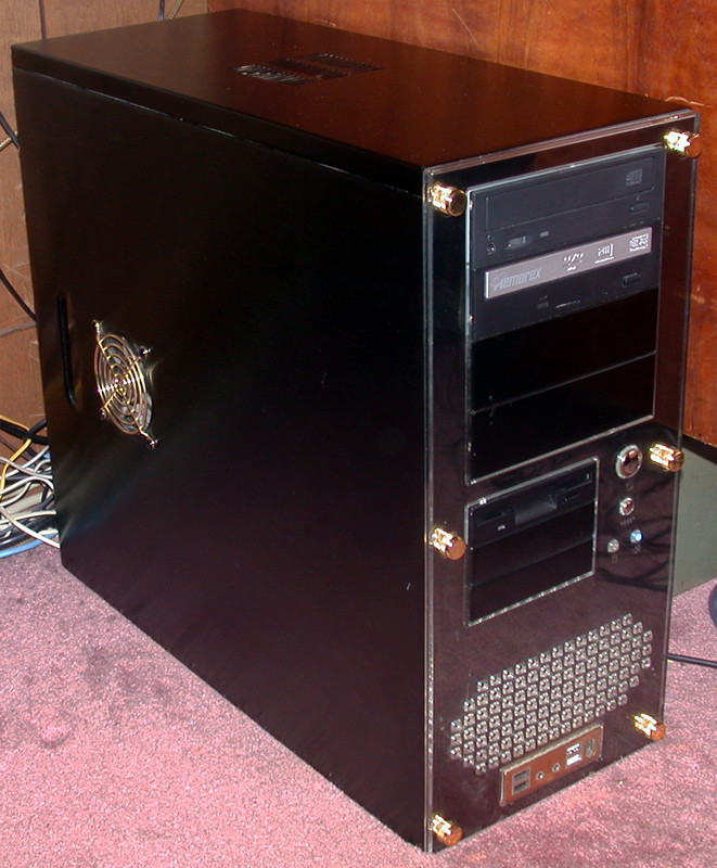

    You don't understand that this computer is 21 years old. Using 2.5-inch drives in desktop computers was not common back then.
    A diagram showing the internal and external drive bays.
    A photograph of the computer in 2004. It was two years old then. Note the original motherboard was an ASUS A7N8X Deluxe. After it failed it was replaced by an ASUS A7N8X-E Deluxe.
