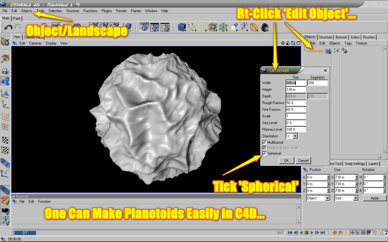

Looking about at the XL6 Thought I would add a few tips... First the 'Edge Bevel' plugin is one of the most important but it's good to have a look at all of them as they were developed to 'fix' features that were missing or not well done...
The 'Edge Bevel' will create an 'edge' (even though XL6-7 do not create them) from 2 or more points that can then be extruded out using the 'Move' tool-

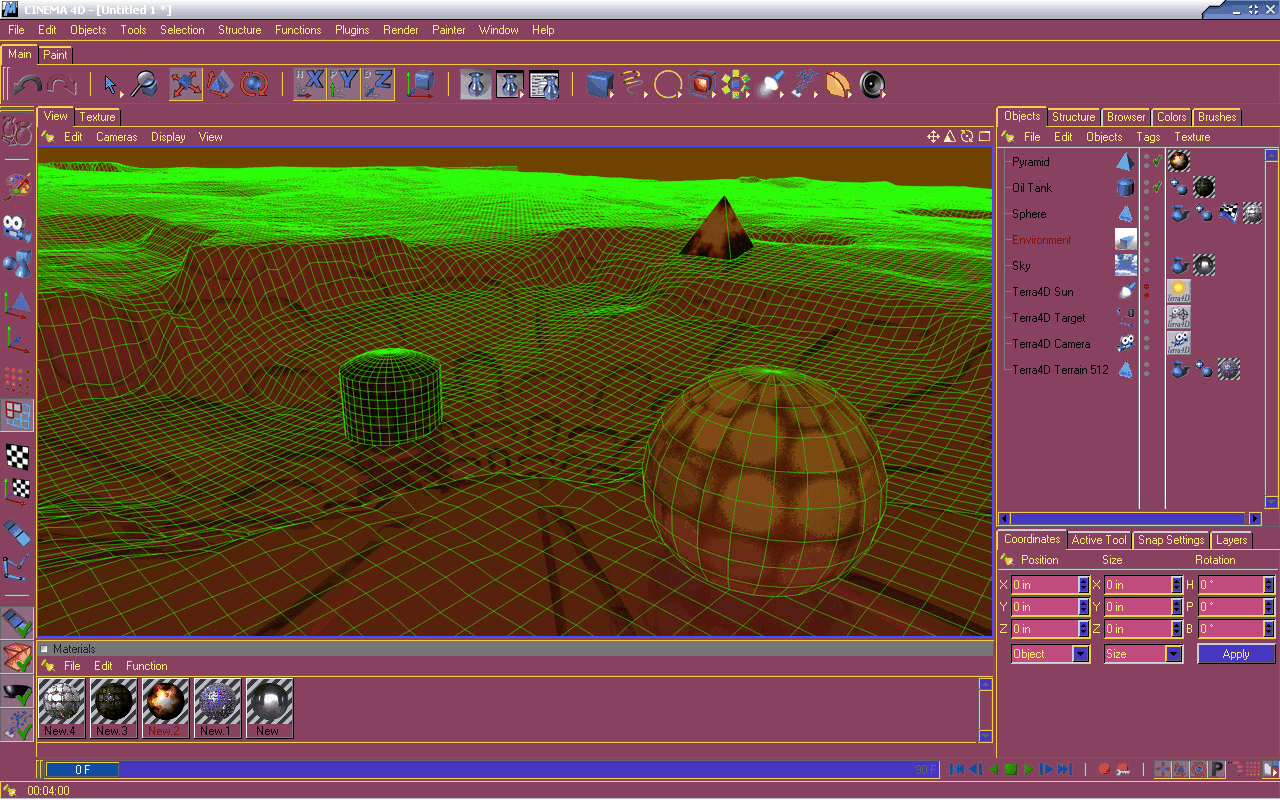

As well as terragen terrains one can make OBJ terrains complete with MTL file & texture... You can apply shadow maps within it... I am talking the freeware HemaHema from Reiner-
https://www.reinerstilesets.de/programme/hemahema/
There's quite a bit of options to use & you can do way better importing your own textures that will be applied depending on your color map settings-
Never used it before, pretty cool...
In this case I tried radiosity but I had already merged a shadowmap with the texture... Not really working out especially with 'studio light' rendering...
So here's 'RGB Balls Of Uranus'...
So I deleted whole radiosity setup & just added 2 omni lights & spruced them up a bit also added the dirtynuts plugin to diffuse channel to make dark areas darker plus a 2Dnoise in the bump channel... Much faster render less than 20 seconds too-
Pulled back so you can see terrain square... It's neither real nor AI... It's NOT REAL!!...

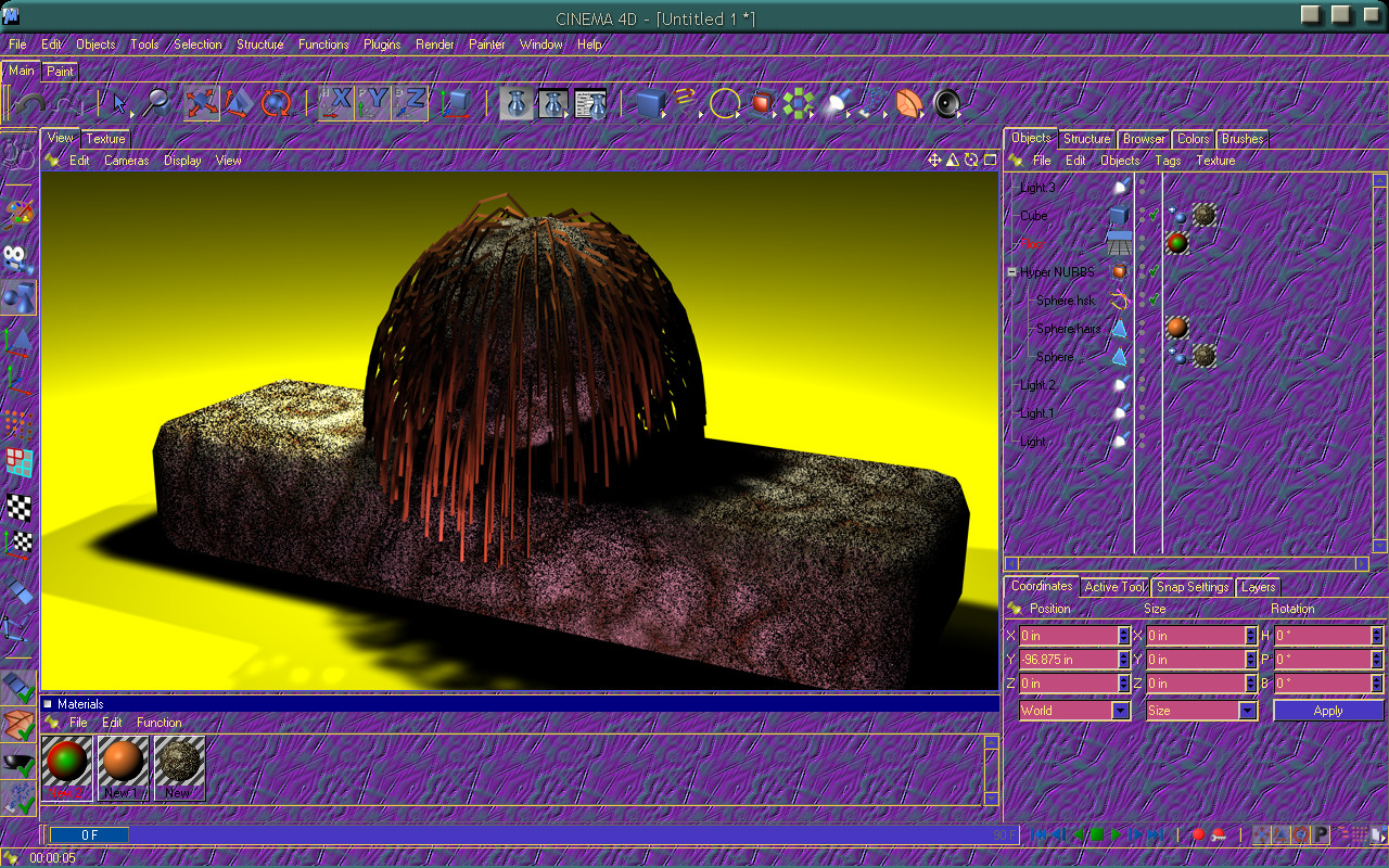

Hair Department in XL7-
