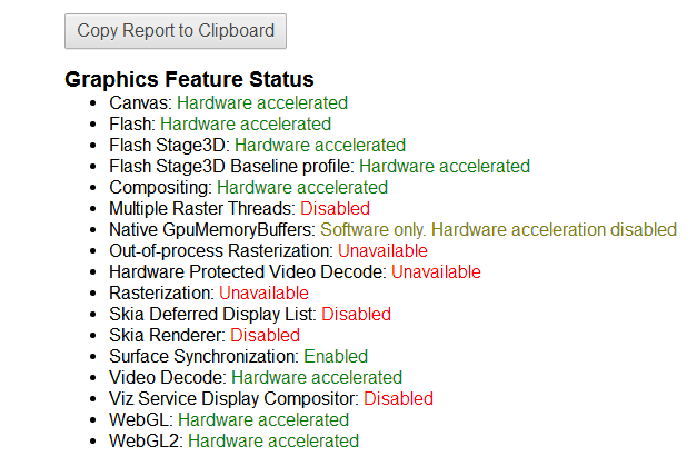

but looking at "chrome://gpu/" .. "Log Messages ::
Log Messages
[452:456:1026/091257.250:ERROR:dxva_video_decode_accelerator_win.cc(1368)] : DXVAVDA fatal error: could not LoadLibrary: mf.dll: No se puede encontrar el m�dulo especificado. (0x7E)
[452:456:1026/091257.484:ERROR:dxva_video_decode_accelerator_win.cc(1368)] : DXVAVDA fatal error: could not LoadLibrary: msmpeg2vdec.dll: No se puede encontrar el m�dulo especificado. (0x7E)
[452:456:1026/091302.203:ERROR:dxva_video_decode_accelerator_win.cc(1334)] : DXVAVDA fatal error: Could not load mf.dll: No se puede encontrar el m�dulo especificado. (0x7E)
[452:456:1026/091302.218:ERROR:viz_main_impl.cc(234)] : Exiting GPU process due to errors during initialization
GpuProcessHost: The GPU process exited normally. Everything is okay.
.... img .... https://i.postimg.cc/HnMyhpSD/Inf-wxp-360c-gpu-01.jpg

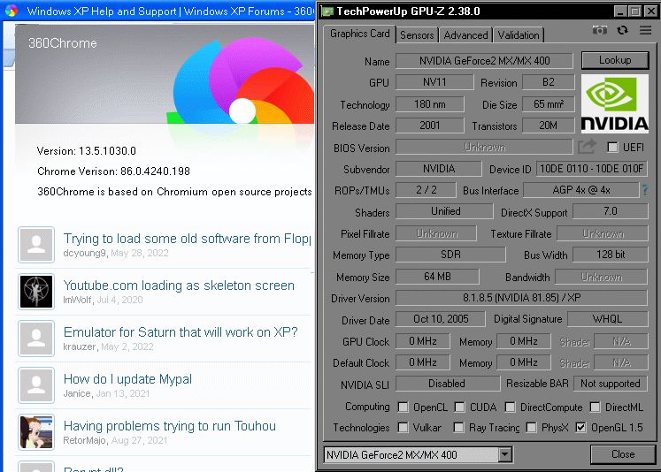

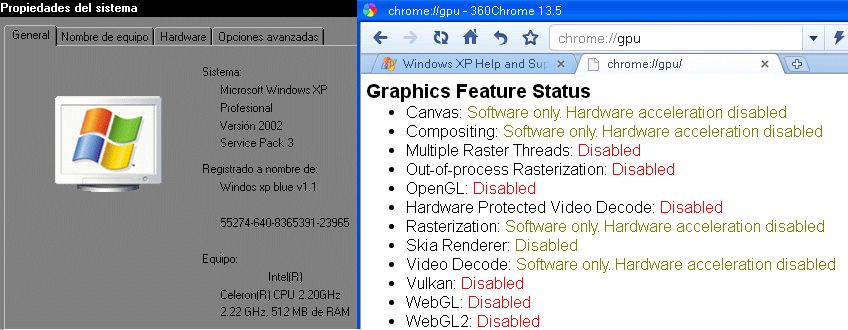

... maybe there is something to take advantage of the gpu of my old system ??
.... img .... https://i.postimg.cc/mgpgCvwQ/Inf-wxp-360c-gpu-cpu-01.jpg

It's not your GPU or system, it appears 360Chrome 13 doesn't support hardware acceleration because I got the same results in Windows 7 x64 with Radeon HD 8450G.. This would explain why I had trouble using Zoom and Skype in V13 - video kept freezing and sometimes wouldn't work at all.
Try 360Chrome 11 instead.
