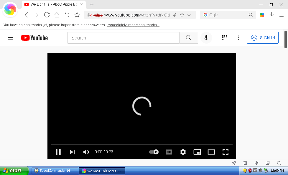

  7. Jacop32
    470
    368

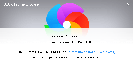

    I decided to give this browser a try.
    Rather than download the link the OP posted which is for an older version (7) I downloaded the most recent 13.0.2250.0 which is supposedly based on Chromium 86. it has a lot of features including built-in adblocker.
    Unfortunately it suffers from the same problem affecting all XP based Chromium browsers. It can't connect to any HTTPS sites due to XP's expired root certificates.
    You will be limited to non-HTTPS sites.
    Youtube loads but doesn't work properlly. Just a bunch of grey squares with no thumbnail previews.
    Clicking on a video results in a spinning circle but video never plays.
    No, Bitchute doesn't work either. whatismybrowser.com doesn't render properly.
    This confirms that the only options for proper web browsing for Windows XP are Roytam's Mozilla browsers which we are all familiar with. Hopefully, Feodor, former MyPal/Centaury maintainer will be able to port Mozilla's Quantum engine to Windows XP in the near future.
