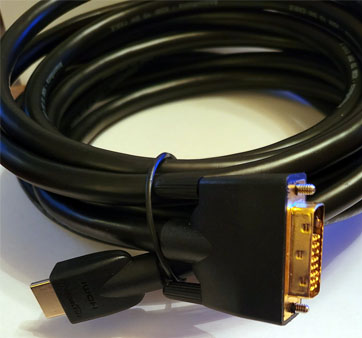

    Electrically DVI and HDMI are the same. All you need is a cable with a DVI connector at one end and an HDMI connector at the other end with the corresponding pins connected. The only gotcha is DVI has no audio so there is nothing to connect on the HDMI side.
    I used a cable like that (shown below) on a computer that only had DVI output to a monitor that only had HDMI input.
    However, I have no way of knowing whether this will work with your setup.
